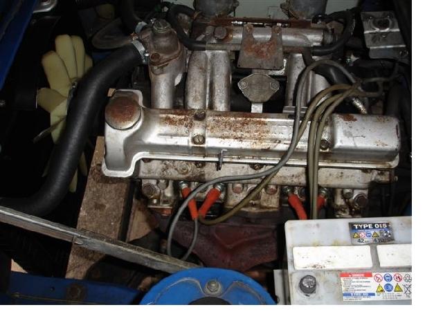

On Saturday i took the plunge, the engine bay went from looking like this ..........

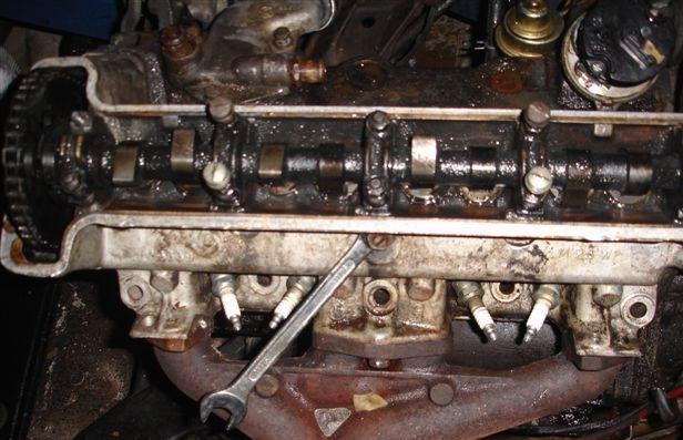

to this.........
I need to change the head gasket and i will change the water pump and timing chain at the same time.
The reason for the title is that with my limited experience and the help of a friend we managed to get as far as removing all the bolts and suds - except one.
One of the studs came out as we undid the nut the other 3 came out after locking 2 nuts together and turning the stud out with much effort. The cente one does not want to budge. And no matter how hard i try and tighten the nuts together they still turn, but of course not with the stud.
